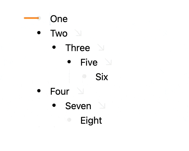

CleanShot 2025-11-11 at 11.54.40
It skirts around the outline, but never ends up where I want it to be, which is sibling after Four.
I know collapsing will help do what I want it to, but it’s an extra operation I don’t think I should be forced to make in an outliner.

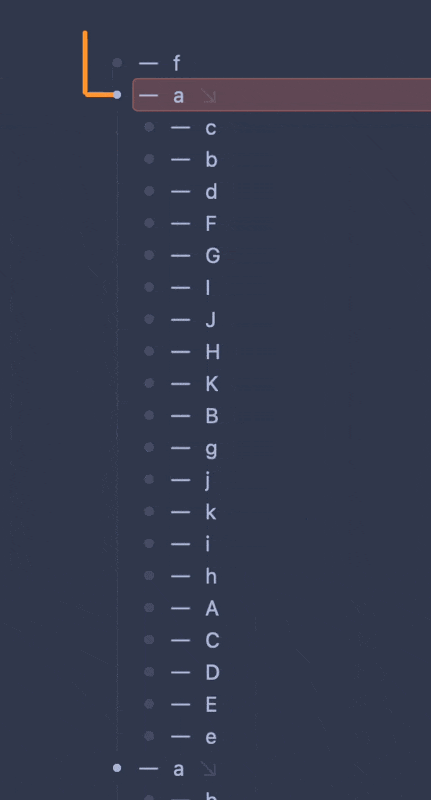

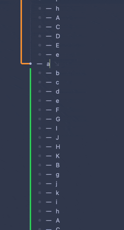

Bike Move down Example 1: Reversible
CleanShot 2025-11-11 at 20.17.38
Bike Move up Example 2: non-reversible
CleanShot 2025-11-11 at 20.18.34
