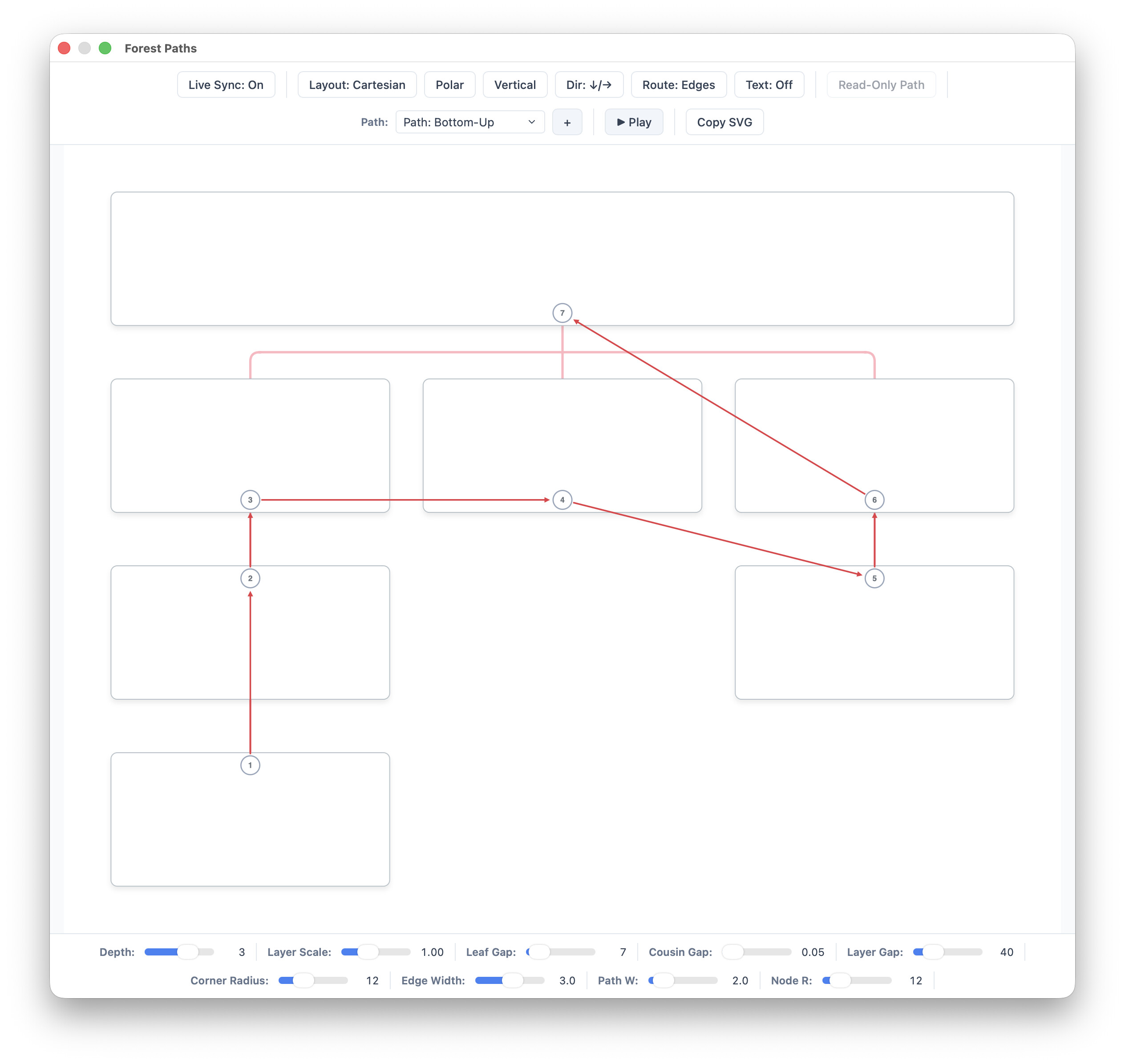

and using a draft Bike extension to visualise both dependency graphs (clarifications and moves to persuade etc) and the narrative paths that are taken through those graphs,
I soon realise that the missing component is time – the particular sequences in which thoughts and texts are reshaped.

An outlining analogue of Draftback, recording the growth and reshaping of trees (or forests) of thought, rather than sequences of text, might, I think, be even more interesting.
Might anyone else be interested in experimenting with such a thing ?

That sounds very good, if you do find the time. I’d like to start some some simple experiments of that kind here, to see if I can at least record and animate a few illustrative examples.

The .ndjson change stream is excellent …
