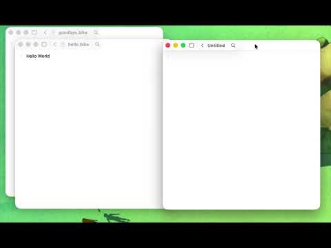

I made an extension for inlining Bike outlines within other Bike outlines! It’s something I’ve been thinking about for ages, and I thought I’d need to develop some kind of helper daemon but it turns out the extension API is enough!
This isn’t “production” or “release” ready, it’s very much a prototype, you can find the code under src/inlining.bkext in my fork of bike-extension-kit, along with instructions for building and installing it
Pretty cool right?
How to use it
  1. Install extension (requires Bike 2.0 preview version)
  2. back up your files (seriously, this extension does programmatic edits, and it has not been QAed)
  3. add a row <inline: $document> where $document is the name of another open document. The inlined document must be open in Bike.
  4. voila
