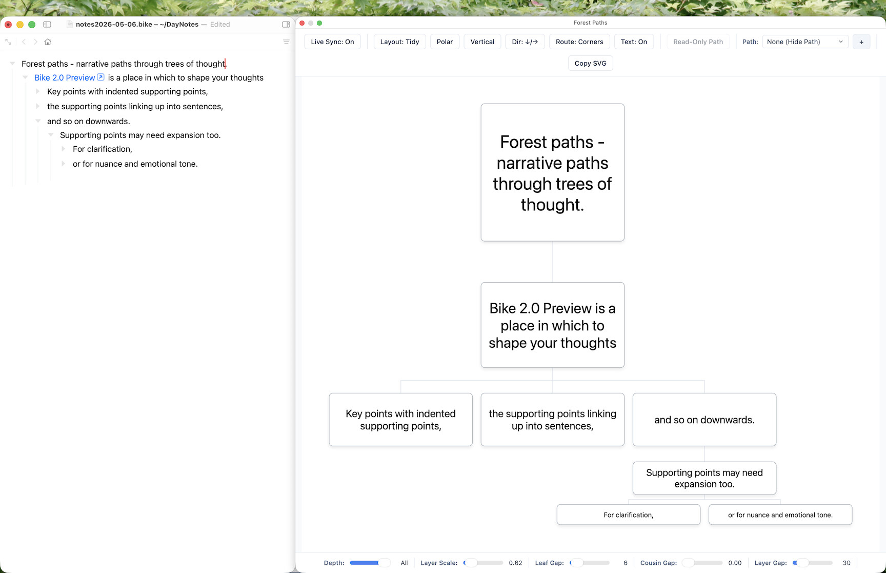

On API, might there be any way of reading the bounds of the active display – something like an {x,y,w,h}, so that we could then set the bounds of the Bike outlining document window, and an extension’s NSPanel ?
(Using Keyboard Maestro here to split the screen between an editing view and an extension display view, but wondering whether there’s scope for doing that inside the extension – I guess that not all users will want to turn to Keyboard Maestro, or continually reposition and resize by hand)
( I typically use, for example, a 1/3 ⇄ 2/3 horizontal split, but mileage will vary )
UPDATE
Ah, Webkit seems to give us that in the DOM via window.screen
(I could then post it back to the app context – direct app context access to screen frame would be nice, but perhaps just a luxury :slight_smile:, and low priority )
If we could read screen frame dimension direcly from the app side, then perhaps we could launch the NSPanel immediately with the dimensions (and position) that we want, rather than adjusting them after learning the display coordinates from an app ⇄ dom exchange of messages ?

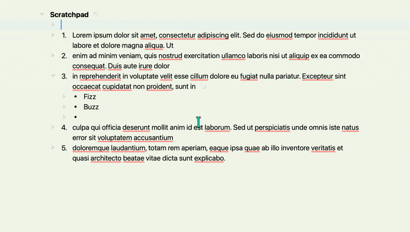

I noticed a small bug when it comes to ordered lists and focusing into a list item. Please see recording below. The number in the list changes depending on whether I’m focused in or out.
CleanShot 2026-05-07 at 11.09.42
But what’s weird is that it seems to depend on the number of characters in the list items. If I cut out some of the text in the list items 1-3, I can’t replicate the bug..
Oh thanks, good find!
Edit Oh, this also shows up in just a long list where earlier items are located outside the top of the viewport.

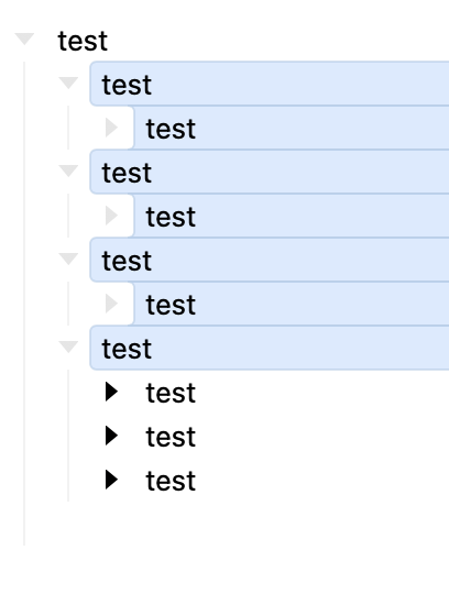

starting with this:

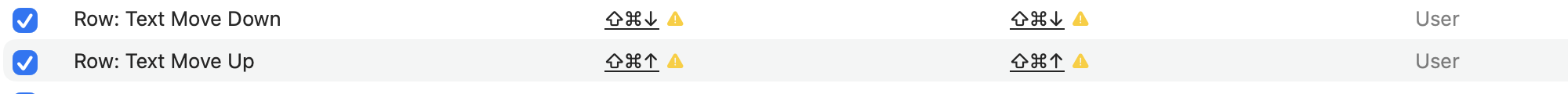

if i select test2 and use cmd-shift-uparrow, to move test2 up, the nesting disappears as i move up.
this is using the custom keybinding:
also, not sure if this is a bug, but when I expand a folded row (cmd-0), the unfolding happens level by level, but when i select everything and use cmd-9, all levels fold up at once, whereas i would have thought the folding up should also happen level by level
also, sometimes after selecting a bunch of folded rows, I need to send cmd-0 more than once to get Bike to respond.
(sent the logs by email)

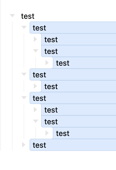

another bug:
starting with this:
folding everything and selecting:
cmd-0 unfolds by level but loses the selection on the lowest items:

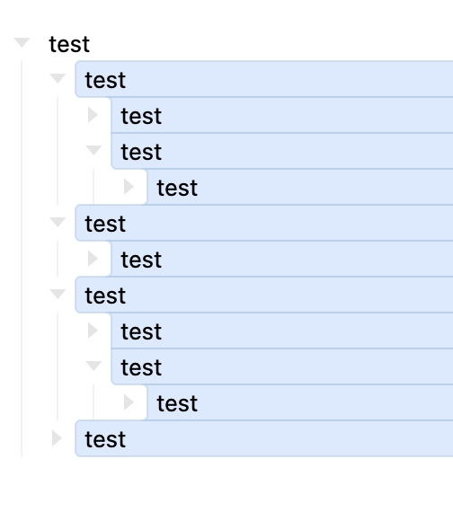

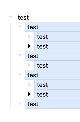

starting with this
cmd-9 (all folds up)
cmd-0 first time (partly unfolds)
cmd-0 second time (next level unfolds)
works this way both orders. definitely not using cmd-opt-9/0
I think this might be due to a recent bug in the last release (or maybe few releases). You can reproduce when you copy/past outline structure into Bike. Then the folding of those pasted rows doesn’t work right first time. I have this fixed for next release.
That is a weird case that I have wondered about. The reason for it is pretty strait forward. The children of that last row are not selected. And so on expand that are still not selected. I’ve tried a few other outliners and they have similar problems.
Or if you consider having a single row selected. And then you expand… it would be weird to select the children in that case.
With that said this interaction has bothered me in the past. I wonder if the rule should be that if you have a single row selected, use current behavior. If you have multiple rows selected then extend selection to expanded children?
if i’m expanding, i want to be expanding the whole suboutline, so losing the selection just forces me to have to re-select. So, yes, i would like to see the selection extended to the expanded children
Ok, that’s expected, but an odd case.
Currently the standard fold command is applied to each row that is visibly selected. So in your first example all the tests are folded.
And expand works the same way. Each row that is selected is expanded. So when you expand in step #2 the is only 4 rows. That are expanded the first time. And then the two addition rows that show the second time.
I’m willing to consider another solution. I guess maybe the collapse case should be adjusted to only collapse top level rows? I think that might be the right answer. Other ideas welcome.
