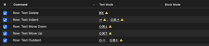

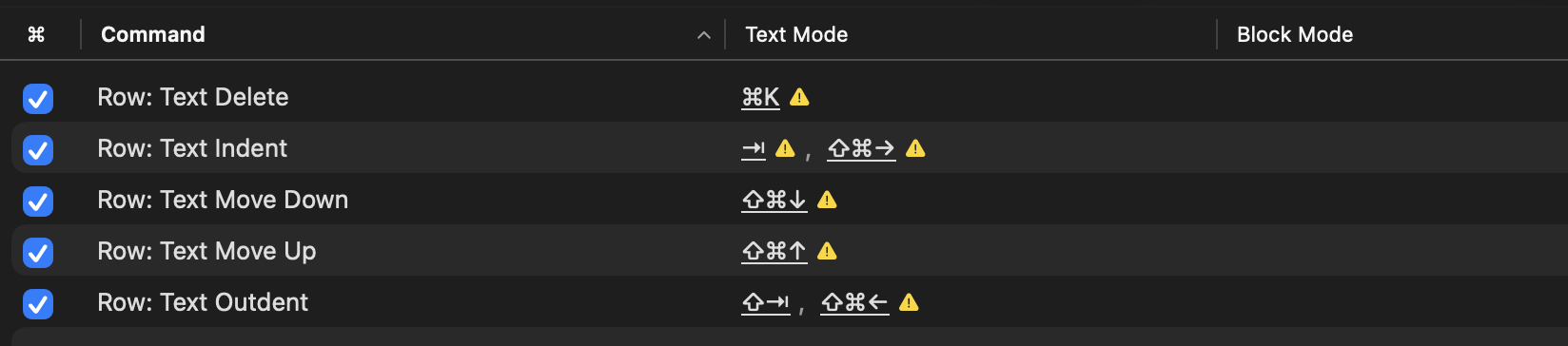

I’ve been trying to figure a solution that will make Text Based moves easier to opt into. The current route of needing to modify a bunch of keyboard shortcuts in Commands Explorer works, but is a bit cumbersome.
What if instead I just bind row:text moves to a common unused keybinding. For example maybe:
  • Control-Option-(Up/Down/Left/Right)
This way if you want text move semantics you can just use/learn that keybinding. If you want both text and outline move semantics you can learn both. And what it avoids is having modify Commands Explorer shortcuts, or having to have a “I like text mode best” setting.
For me personally that might conflict with window management shortcuts, so I wouldn’t avoid remapping either way. But might be viable for those that don’t have external window managers, I don’t recall any system commands using that combo.
i’m using cmd-shift u/d/l/r (+ tab and shift-tab for r and l) because i find ctrl-opt awkward to type. I suspect everybody will have their own preferred keybinding.
But since this is a coherent subset of commands, maybe you can create an option in settings to group-specify the keybinding, with ctrl-opt being the default.
