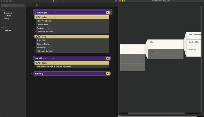

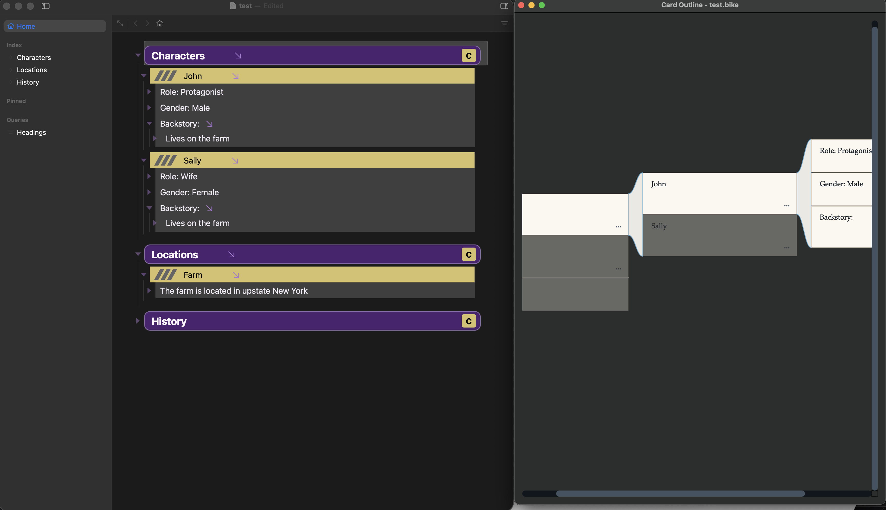

Absolutely, totally understand feature creep, as a coder myself. Because I like to see what people are doing with my software, I wanted to share a sample (I just made up some quick info not in my book) to show the type of setup I am exploring. I really like visual distinction, which is why I love the freedom in Bike2 to play around with such intense styles. Here, I added some graphics to the yellow line, and the C at the end of the row opens up a python script that shows the .bike file in miller rows similar to Ginko Writer (so just gives you yet another way to visualize the data.
Given I wouldn’t want to use this setup for all my other uses of Bike, I’ll think of how I can quickly switch for now as I normally have like 5-6 bike documents up that I am actively working with for all sorts of reasons.

I do, and thanks! Is that second window an extension panel? Or another app reading file changes?

The second window is another app (python app) just reading the bike file directly.

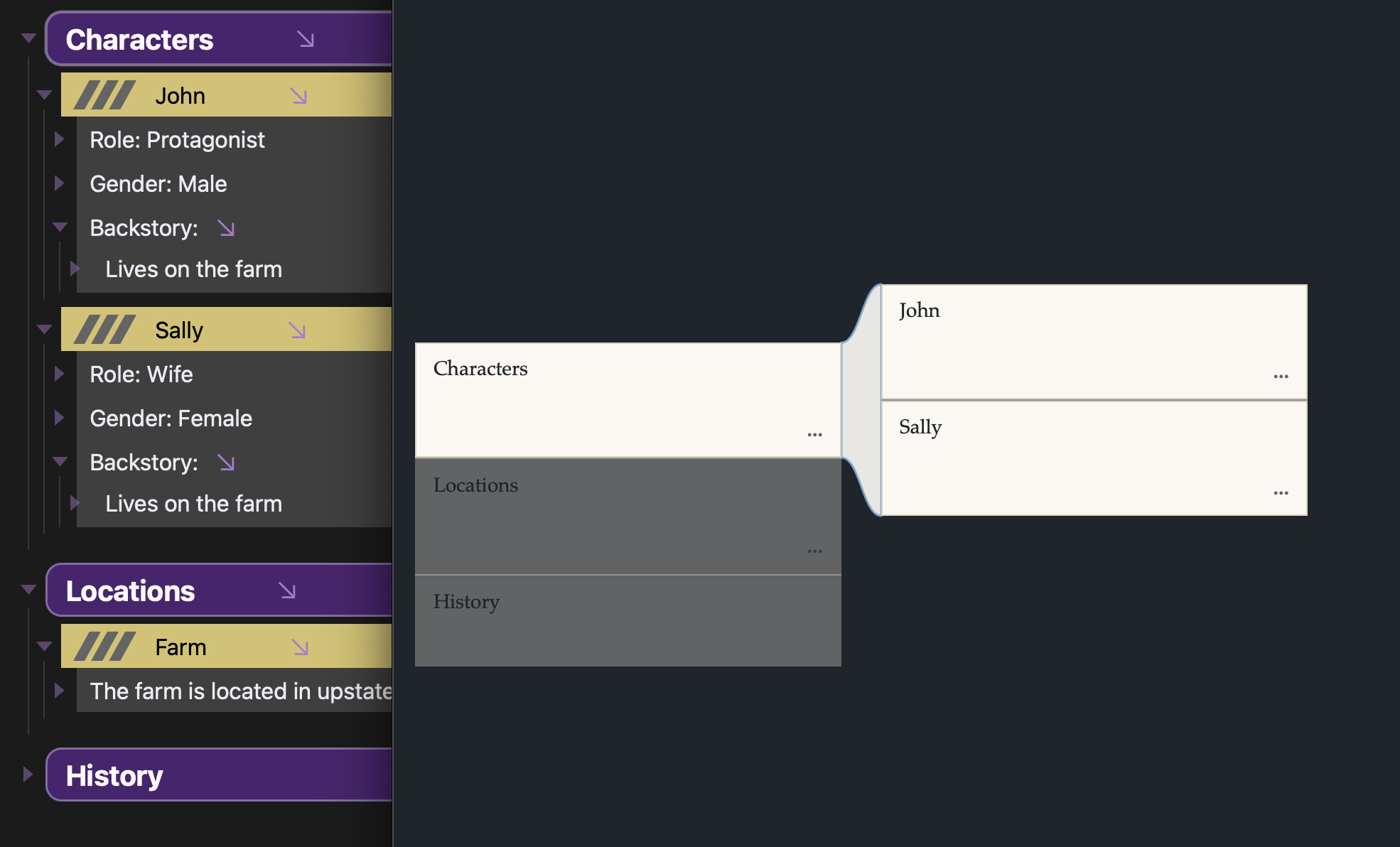

The nice thing that could allow is two way communication between the visualization and outline. Visualization can update immediately as outline changes. Clicks in visualization can be sent back to changes in outline editor.

Alright, I will work on porting the python over to the extension, as I’d like to make that tighter anyways.
Yes, the theme is inside the extension. As I mentioned, I’ve been letting codex with 5.5 medium doing a lot of the heavy lifting at the moment before I dig into the code. So for now, I’d just have to leave that window up and start/stop the extension to turn it on and off as I switch between different windows.
And now this is all done within Bike2, no external application.
