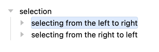

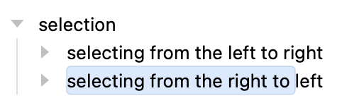

not sure when this behaviour started. if if doubleclick to select a word and drag left, the originally selected word loses its selection
but if i drag right, the originally selected word stays selected
I think I can add here that if you double-click to select a word, and then do opt+shift+left, the behaviour is the same—it first deselects the word, then advances selection to the left.
Thanks, I’ve just fixed this case.
This is a little inconsistent with above, but I think I’m going to keep this behavior. The system also seems to work this same way. And it’s a pretty edge case, and to solve it would mean adding another bit of state to selection. I think current behavior is good.
