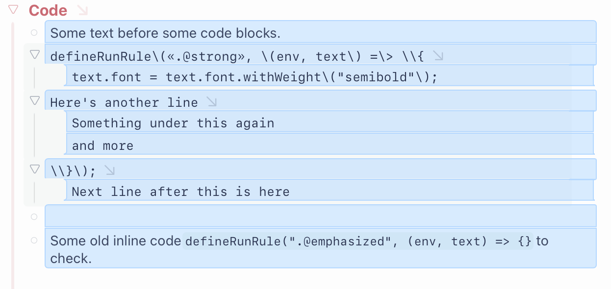

Another thing: I wonder if background.zPosition doesn’t work as intended..?
(As always, it might just be because I’m doing something dumb. :sweat_smile:)

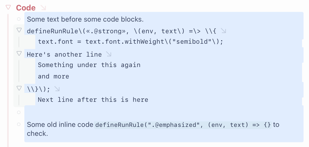

I’m trying to give a background colour to my codeblocks — and to make them blend, I don’t want to use opacity on the colour. (I instead mix the accentColor with the backgroundColor.) However, even though that one has zPosition -20, the block selection (with -2) doesn’t go _on top_.
If I change the latter to 1 it DOES go on top, but then it also goes on top of the text…
My code for the codeblock:

And for the selection (which I think is unchanged):
  row(`.selection() = block`, (context, row) => {
    let values = computeValues(context)
    row.decoration('selection', (background, layout) => {
      background.anchor.x = 0
      background.anchor.y = 0
      background.x = layout.leadingContent
      background.y = layout.top
      background.width = layout.width.offset(layout.leadingContent.scale(-1))
      background.height = layout.text.bottom.minus(layout.top).offset(row.text.margin.bottom)
      background.color = values.selectionColor.withAlpha(0.5)
      background.border.width = 1 * values.uiScale
      background.border.color = values.selectionColor //values.selectionColor.withAlpha(0.25)
      background.corners.radius = 3 * values.uiScale
      background.mergable = true
      background.transitions.color = false
      background.zPosition = -2
I’ve considered a workaround where I do a separate rule for selection if it’s a codeblock — but that shouldn’t be necessary, right?

The issue is that code block is a row.text decoration, while selection block is a row decoration. Row decorations can stretch to entire branch, while row.text decorations are just for the rows text … those decorations are not siblings, and so zPositions can’t change their relationship.

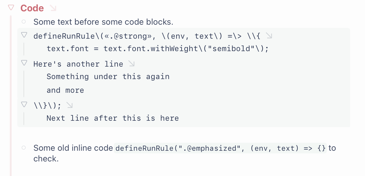

Hmm, I see. I tried some things that made it a bit better:
I changed the codeblock to be row decorations instead, and the inline code to use withAlpha.
The reason I don’t want to use Alpha is that I want the codeblock rows to blend together — and with Alpha you’ll see the different layers.

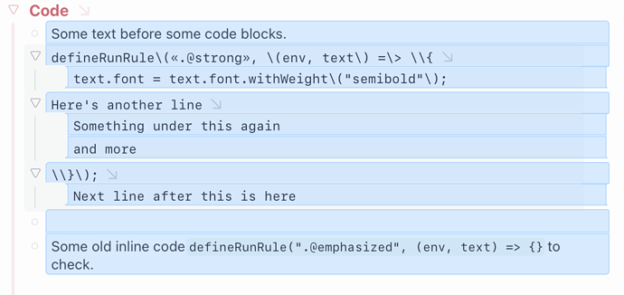

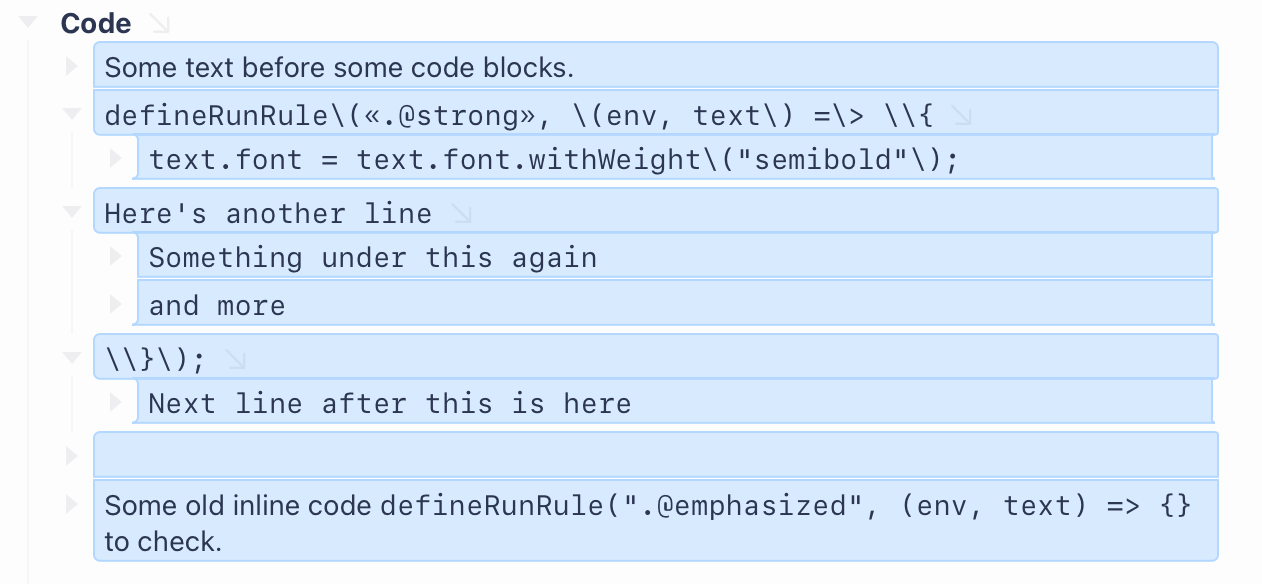

The selection is still a bit weird, though: I don’t know why you get those rounded corners on the right, and in general I don’t love how uneven they are.
And, to be clear, this is an issue with the default styling as well. (Like, why doesn’t the rows stop at the same place on the right?) :backhand_index_pointing_down:t2:

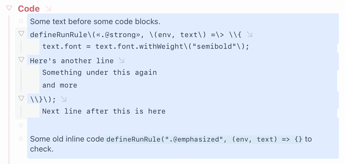

I think I got it looking a bit better by doing a similar thing that with the codeblocks: Removing the border, and then mixing the colour with the BG colour instead of using alpha. (I made it a bit lighter after taking that screenshot…)

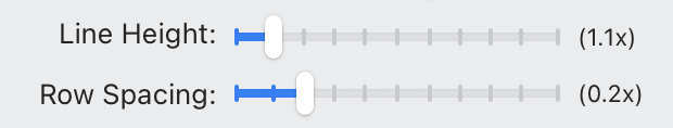

(BTW, I’m using this setting — which might make block selection look less nice. :backhand_index_pointing_down:t2:)
