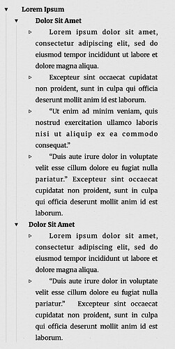

I think I’ve honed into an extension system I’d like to develop for myself in the near future, but I’m curious…is it possible to visually force indent the first line of a row and use justified alignment with stylesheets?
Sorry, at the moment neither of these are possible.
I think leading indent might be confusing, combined with indentation levels? Maybe make mockup of what it would look like (or is there an outline that already does this?). I’m willing to take a look, but probably won’t try adding without some visual examples to make sure it’s a good idea.
Justification is also not possible currently, though that would be easier to add. I think I didn’t add by default because I also wasn’t sure about handling the other alignments, and how they might confuse outline structure… again I don’t love the idea of leading whitespace. Though I think for start I could just add two alignment options (left, justified) and skip center and right for now.
Thoughts?
I’m not sure I’ve seen that anywhere. OO supports justification but not first line indents.
My goal is to have it visually resemble a real book rather than a working document. I find it helps with motivation, but I’m also pretty sure it doesn’t make sense to anyone but me :slight_smile:

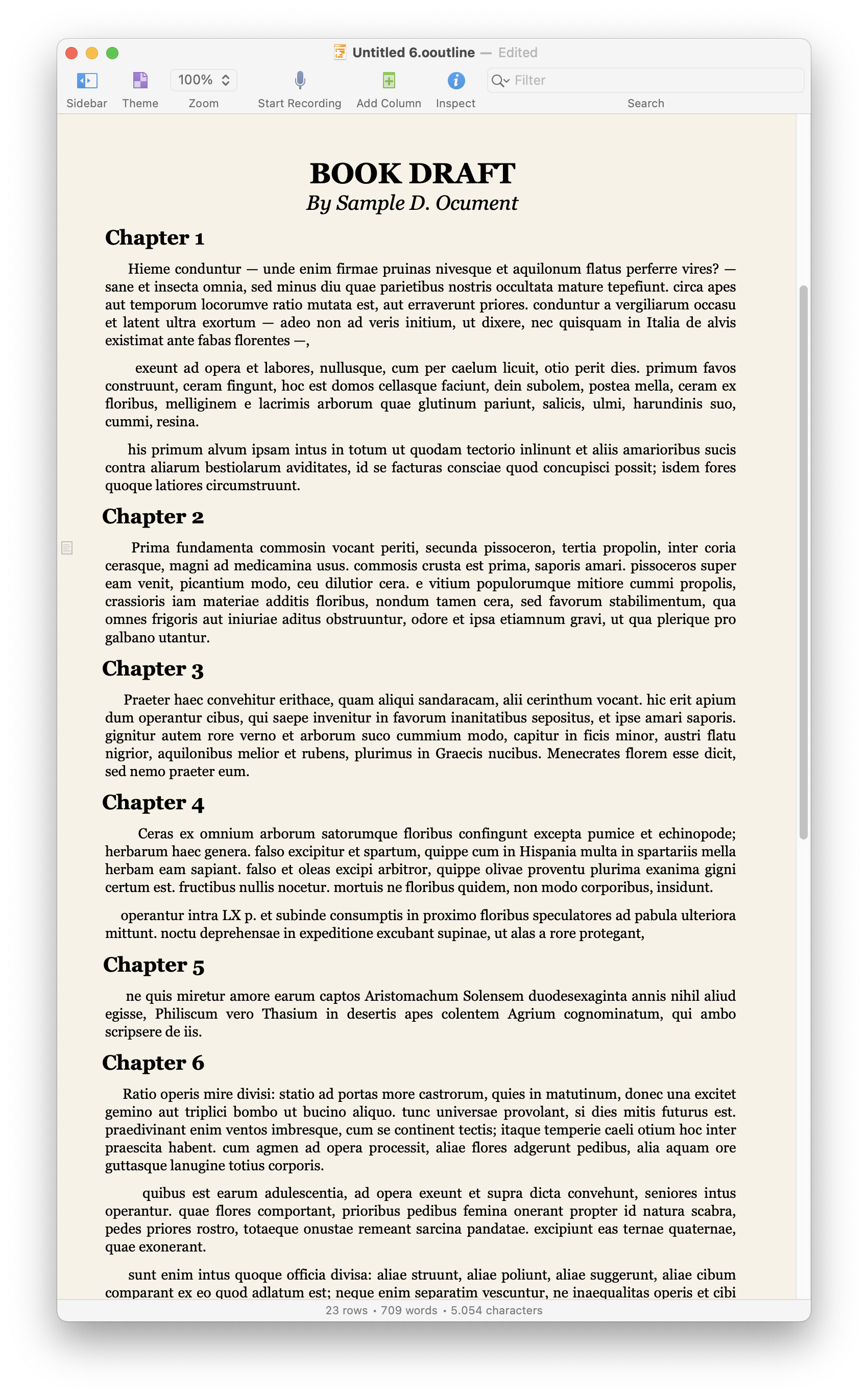

Here’s what it looks like in OO after I manually indent first lines (but this template has some other specialties, like not indenting Level 3 rows etc.):

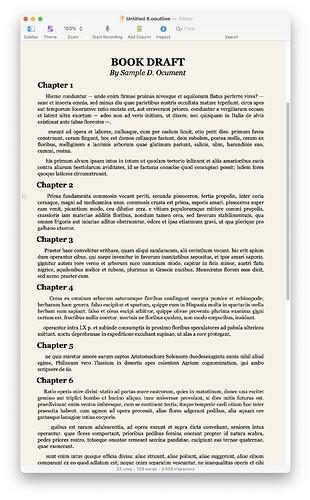

EDIT:
It’s actually possible to do this in OO with a simple script. There’s an attribute in Omni Automation that they don’t include in the styling UI :slight_smile:

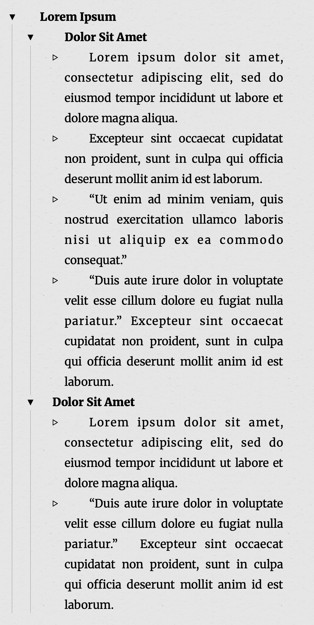

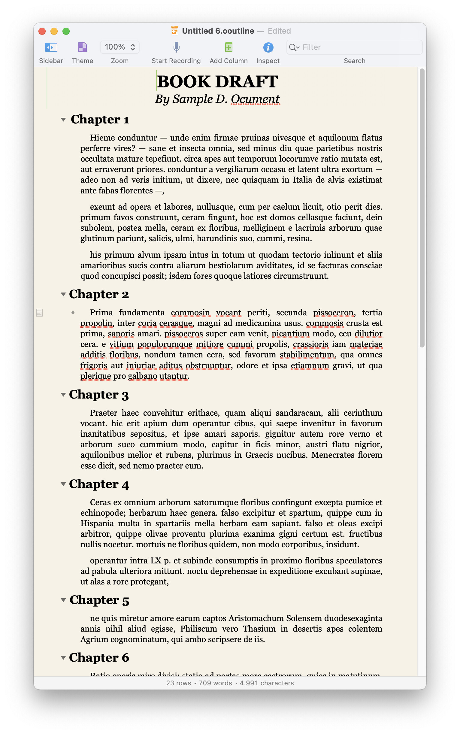

Here’s what that looks like with indented children and handles for Level 2 rows visible and other handles visible on hover:
Actually, I’ve taken a look and seems things are opposite of what I thought. You can hack in a first line indent like this:
run('.first-child() = true', (editor, text) => {
    text.padding.left = 22 * editor.uiScale
On the other hand justified text is going to be more difficult to support and is unlike to be added during this 2.0 development cycle.
