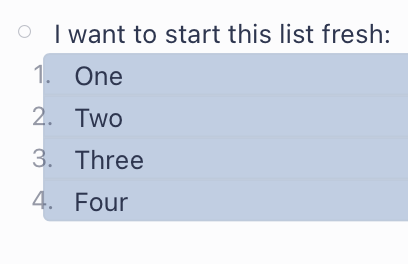

One related issue I’ve had is the following:
Let’s say I have a list of items, and I want to start over fresh on that list:

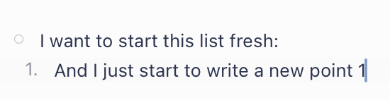

The way to do that, that’s intuitive for me, is to select the items and just start writing:
(The editor style is a work in progress — don’t mind the selection not hitting just right. :smiling_face:)

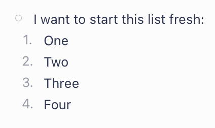

However, doing that doesn’t do anything now. And hitting backspace and then starting to write doesn’t work either… I have to delete, and then move the cursor to where I want it again. :confused:
I think it makes sense that hitting backspace deletes everything, so I don’t really have a block to write into. But just starting to write should just add text to the top selected block, IMO.
