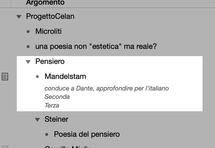

I noticed that if I open an .OPML file (omnioutliner in this case) in Bike the notes filed is missing…
I suppose this happens by design but… any way to get that field in a .bike document?
in Bike the notes field is missing…
Not missing – just not displayed.
The problem there is that Omni is using a _note attribute (not part of the OPML standard) to hold those ‘note’ lines, rather than making them OPML children of the parent line.
Bike preserves attributes on read and write, but doesn’t display them.
It would be possible to write an import script which converted those attribute lines to actual children of the row which contains them.
(It’s possible that I’ve already written code which does that – I’ll try to take a look on Sunday, or later in the week)
