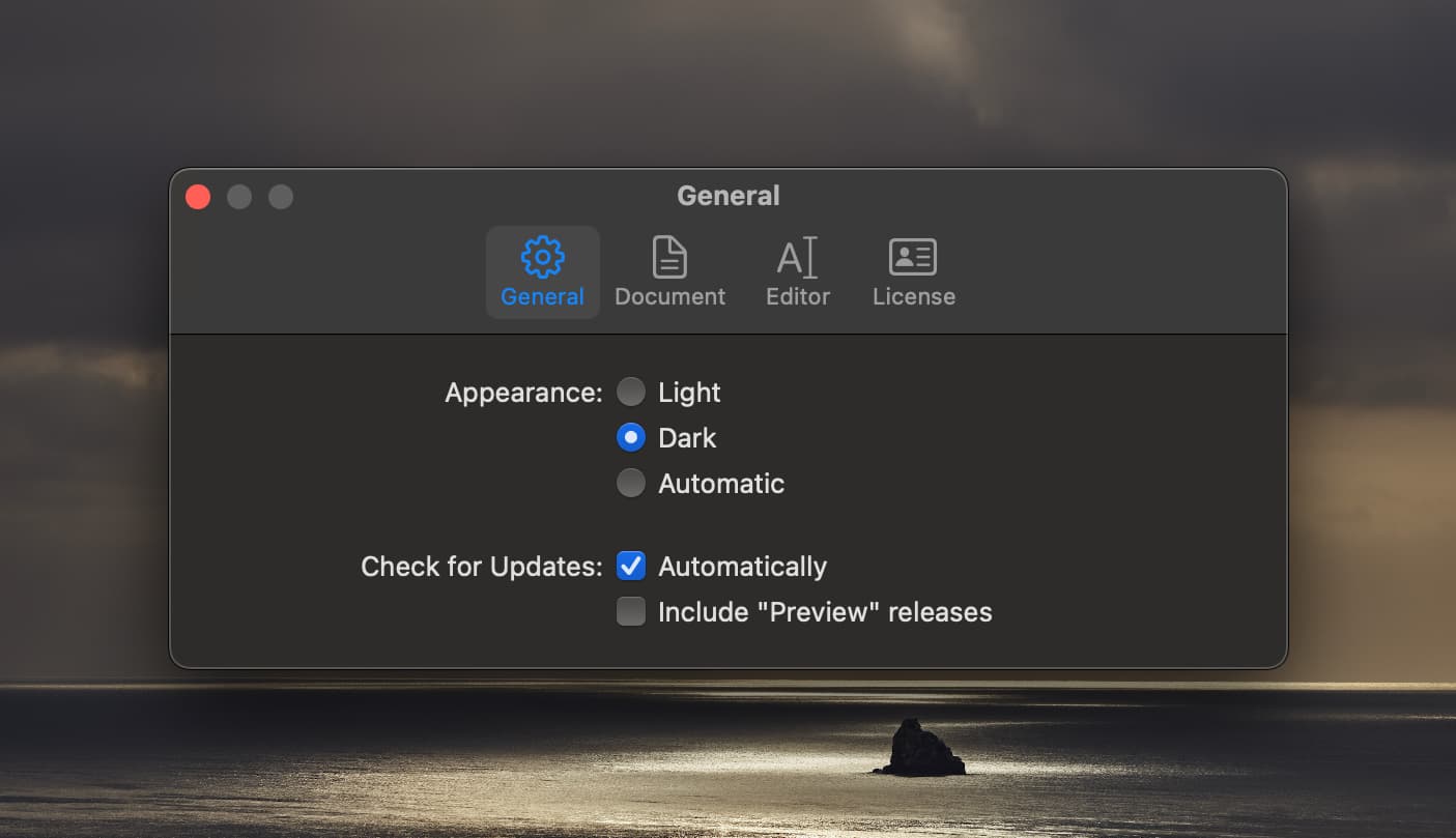

The latest preview release is now available and I think fixes this problem:
