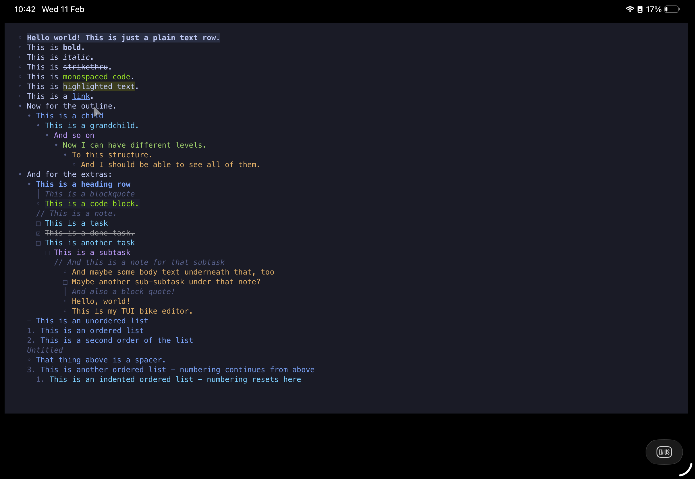

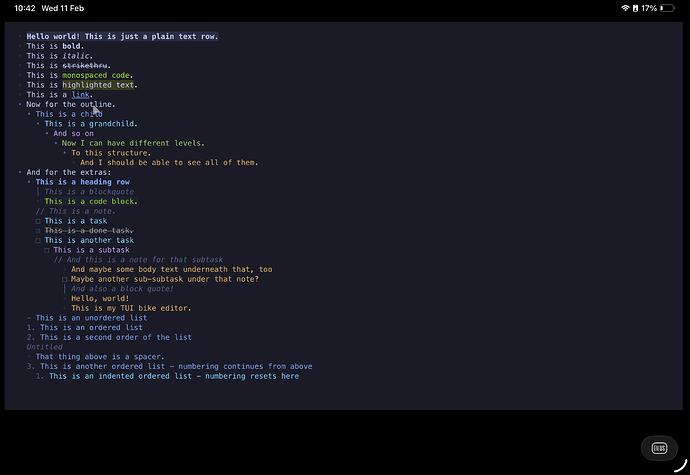

I went as far as vibe coding a TUI that runs in a-Shell terminal on iOS. That’s a nuclear option if I desperately needed to address .bike files, but I don’t like how it handles file writing and did not find time to further work on it (besides, it works reasonably well only on iPad).
