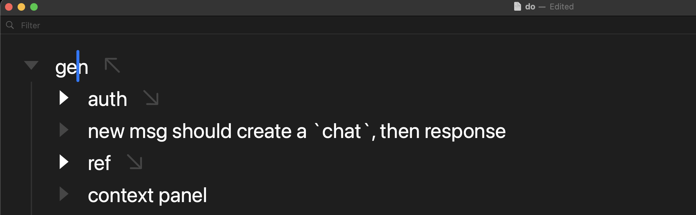

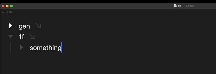

Given this:
I want to deterministically go to gen and focus in on it like so:
I need some way to script open/focus a certain title by its text content, can I do that somehow?
Thank you: :black_heart:
I only need to choose from the root nodes too. I will have specific keybinds to jump between root nodes basically. I just need deterministic way to do this fast.

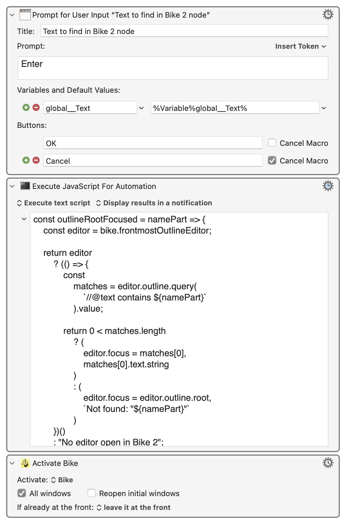

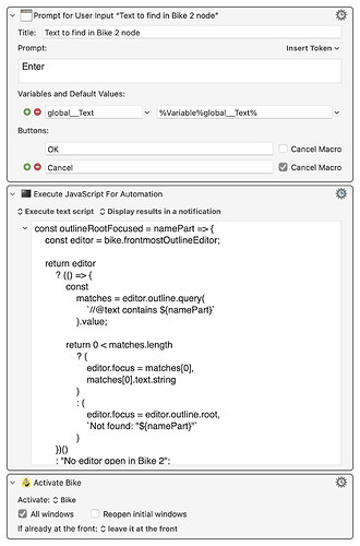

If the idea is to:
  1. enter a string
  2. focus the Bike editor on the first row containing that string
then perhaps something more like:
const outlineRootFocused = namePart => {
    const editor = bike.frontmostOutlineEditor;
    return editor
            const
                matches = editor.outline.query(
                    `//@text contains ${namePart}`
                ).value;
            return 0 < matches.length
                    editor.focus = matches[0],
                    matches[0].text.string
                    editor.focus = editor.outline.root,
                    `Not found: "${namePart}"`
        : "No editor open in Bike 2";
return Application("Bike")
    .evaluate({
        script: `${outlineRootFocused}`,
        input: kmvar.global__Text
as in this draft of a Keyboard Maestro macro:
Node focused by found text.kmmacros.zip (1.9 KB)
