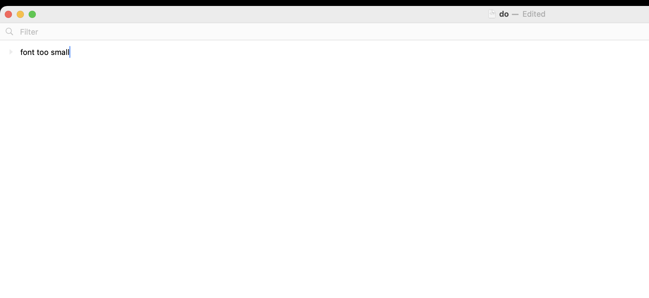

How to change font size in Bike 2.0
default font is too small
Getting this working through Bike > Settings is goal for next release.
Currently the only way to do this is dive into Bike 2 extensions, and provide make a custom style. If you decide to go that route fasted path is to just copy the style in src/bike.bkext/style, move it to a new extension. Use a different name for defineEditorStyle and change the font that’s used in util.ts from editor.theme.font to Font.systemBody().withPointSize(18).
