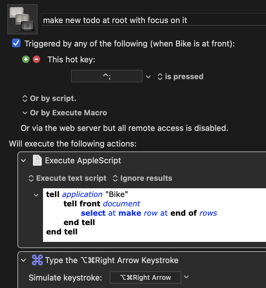

I have this script that @complexpoint kindly shared
tell application "Bike"
	tell front document
		select at make row at end of rows
	end tell
end tell

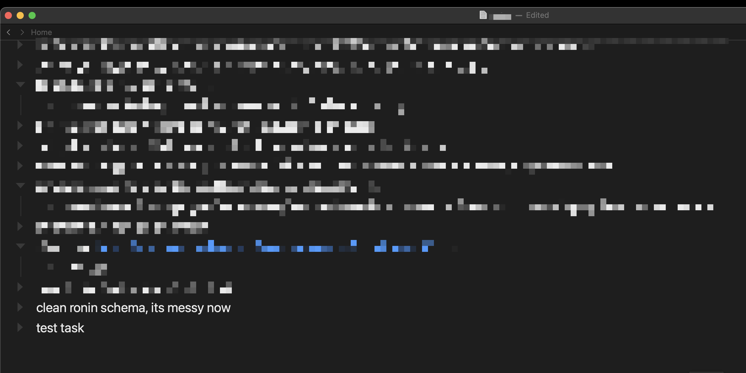

if i activate it from say somewhere deep in my bike document, so from here:

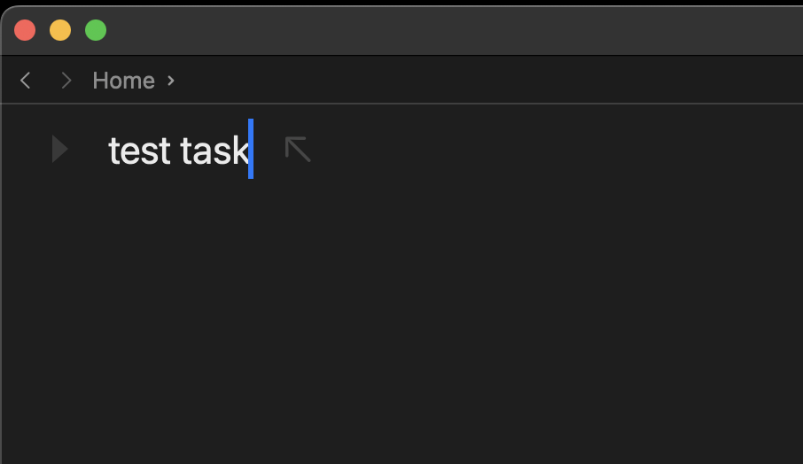

I activate and write something:

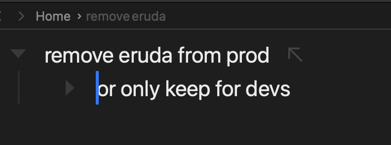

Then when I do Go Back, I see:
And Go Back again does nothing too.
I need a way to create a task into bottom of Home but also be able to Go Back to where I was before I ran above macro.
Is this possible to do?
