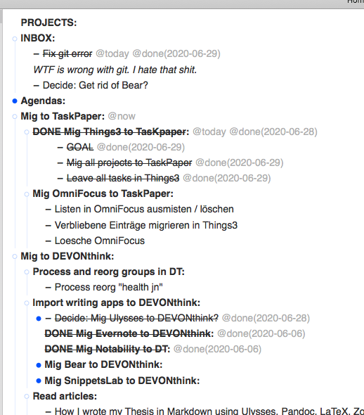

To be more specific: Items up to level 3 are successively folded by successive hits of the key combination. But then folding stops there.
See screenshot:

In your example above, it looks as if DONE Mig etc is not indented under - Decide ...,
(not sure if that reflects the structure you want)

My indents are all tabs. But as you can see in the screenshot below, my projects have children, not siblings, and the children won’t get collapsed until level 3.
So I position the cursor on the project “Mig to DEVONthink”, and hit “Shift + Cmd + 9”, but nothing happens.
folding-stopped-at-level3_
I wonder if any of the tabs are preceded by space characters ? I notice that the degree of indentation in the GOAL, Mig, Leave sequence is visually fractionally deeper than that in the Listen Verbliebene Loesche sequence.
Opened the file in VS Code editor, searched for a tab preceded by space, could not find any entry.
But your observation solved the problem. Deleted the extra tab in front of the children of the project “DONE Mig Things3…”, and now everything works fine.
Thank you very much. Never would have found that one. :slight_smile:
