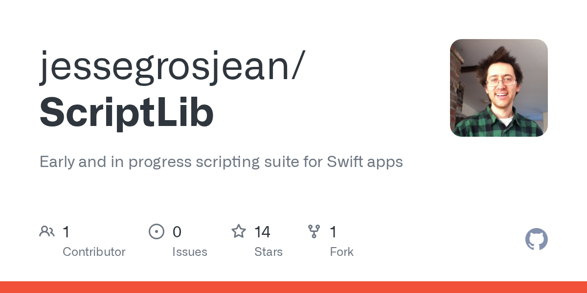

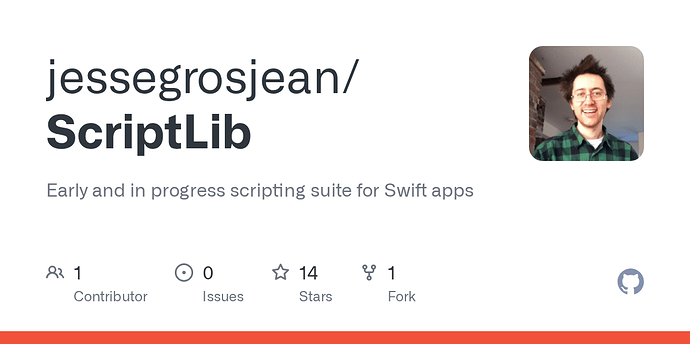

I’m on the lookout for an existing Swift “scripting” package that I could use. Omni used to have a lot of open source frameworks, but I can’t find anything for Omni-Automation. Is anyone aware of a package/lib/framework to help with building a javascript context based scripting environment? If so please let me know.
Since I haven’t been able to find anything so far I’ve started my own “ScriptLib” package here:
There’s nothing Bike specific there yet, but it’s currently the foundation that I plan to build Bike scripting support on assuming I don’t find an existing library. Please take a look and try out the little that’s there. I’m unlikely to work much on it for the time being and would welcome anyone to start looking at the code and pushing it forward with pull requests.
