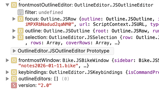

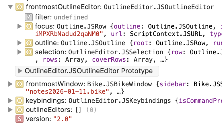

I wonder if the bike.outlineEditors property is functioning as expected in Bike 2 Preview (254) ?
In the Safari debugger this morning I find that:
  1. bike.frontmostOutlineEditor, is bound, as expected, to the editor I am looking at, but
  2. bike.outlineEditors yields an empty array …
Hum, it doesn’t seem to work for me either… though it does work in prev version and it’s also working on my local dev version. Anyway, appears fixed for next release.
