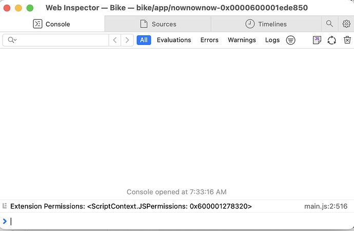

I tried, probably clumsily, to see a result of this kind of thing in the Safari debug console:
export async function activate(context: AppExtensionContext) {
  console.log(
      "Extension Permissions:",
       JSON.stringify( context.permissions )
but perhaps an async activate function doesn’t really get a chance to leave a string in the console ?

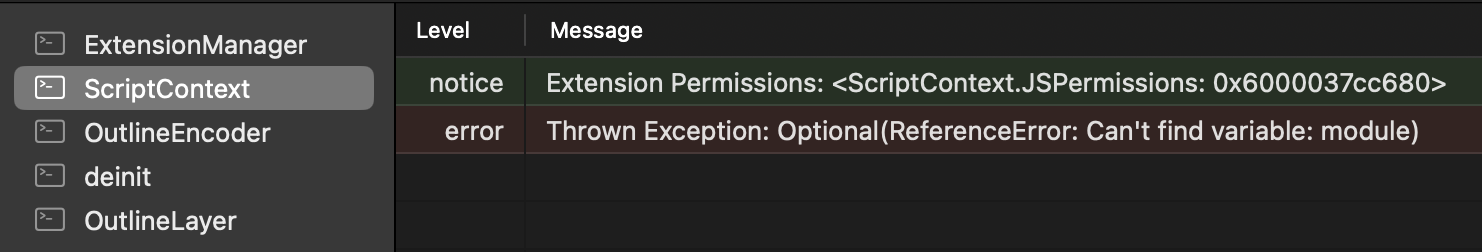

  3. Two potential problems that I can think of … a) Maybe you opened the wrong context from the Safari > Debug menu? (I did on my first test). For example I opened the “bike” context, but my logging code was in “tutorial” context. b) Make sure you are not filtering the log, default log level is “notice” and you won’t see that if you are filtering to only show warnings… Should be that “All” is highlighted above the log.
I’m not sure why you would not see this in your log.
Many thanks – I had mistaken context.permissions for a JS dictionary.

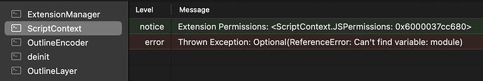

I can see it in Window > Logs Explorer > Script Context

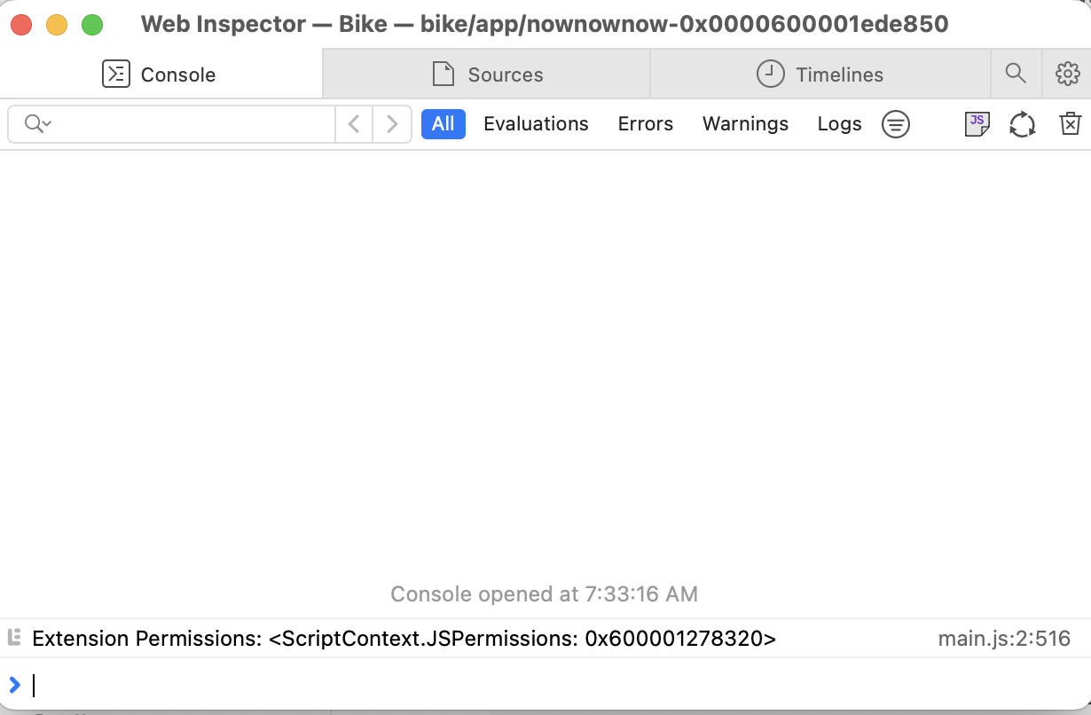

FWIW still not seeing it here in the Safari debugger console:
( I assume that the Logs Explorer message about the name module is not relevant here )
[error] ScriptContext: Thrown Exception: Optional(ReferenceError: Can't find variable: module)
(In any case, not in any sense an impediment to progress – just me stumbling around a bit as I experiment to get a sense of things )
Scratch that, forgive me – perhaps I should have opened the console a few more lines – it’s showing now.

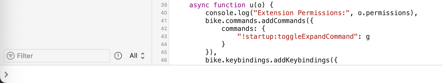

Extension keybindings seem to fire as predicted in documents opened from file, but I wonder if there is an edge case with newly created documents (not yet saved and reopened) ?
Is it possible that app extension activate events may be bypassed where a document has not been opened from file ?
With the following !Startup extension for example, I seem to have to save and reopen new documents before I can use the extension-defined keybindings (e.g. ⌘8 for toggle expand).
(No obstacle to use, and possibly just some error of mine in the extension code, or some documentation that I have overlooked)

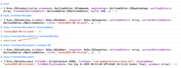

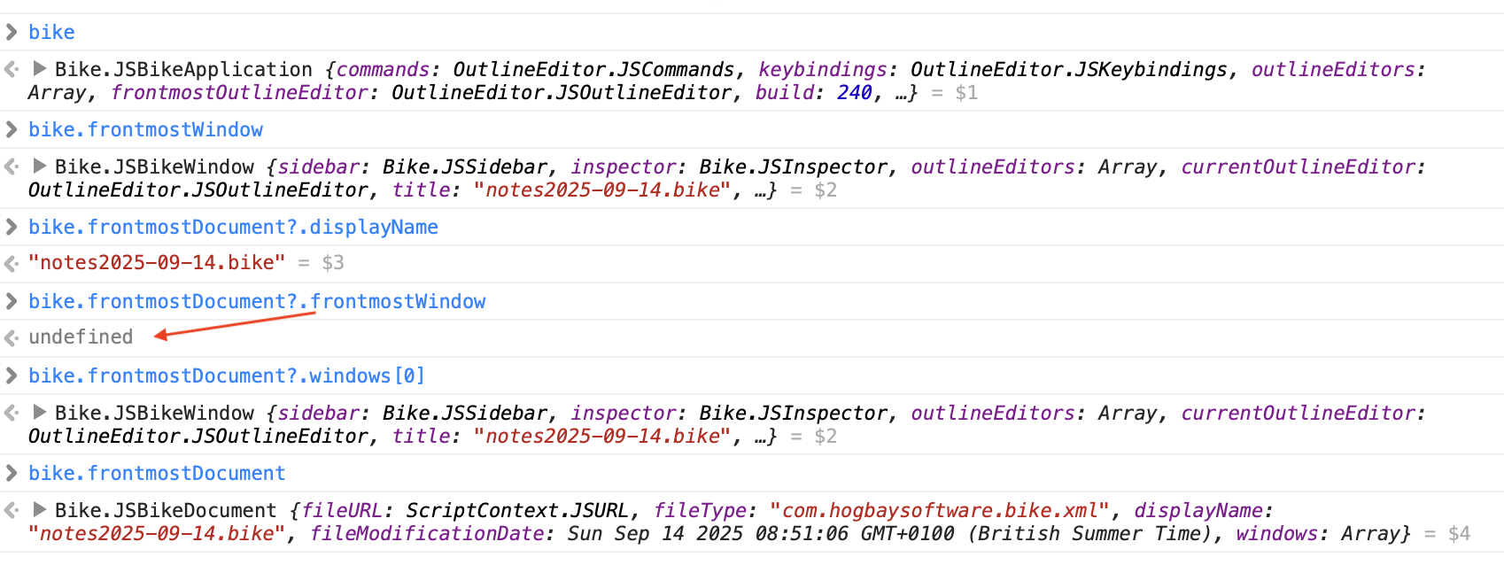

A quick question about the frontmostWindow property of the Document interface (I’m using Bike 2.0 Preview 240)
In the extension kit I see:
export interface Document {
  readonly fileURL?: URL
  readonly fileType: string
  readonly displayName: string
  readonly windows: Window[]
  readonly frontmostWindow?: Window
and I notice that in contexts where expressions like:
doc.windows[0]
successfully return a Window value, I am finding that
doc.frontmostWindow seems to return undefined
(the frontmostWindow property on the bike (rather than Document) object is returning a defined value)
For example, at the Safari console here:
Oops, looks like I never implemented that on Swift side. I’m just making a release this morning and I’ve added a fix for this. I also changed things so that document.windows will always return windows in front to back order.

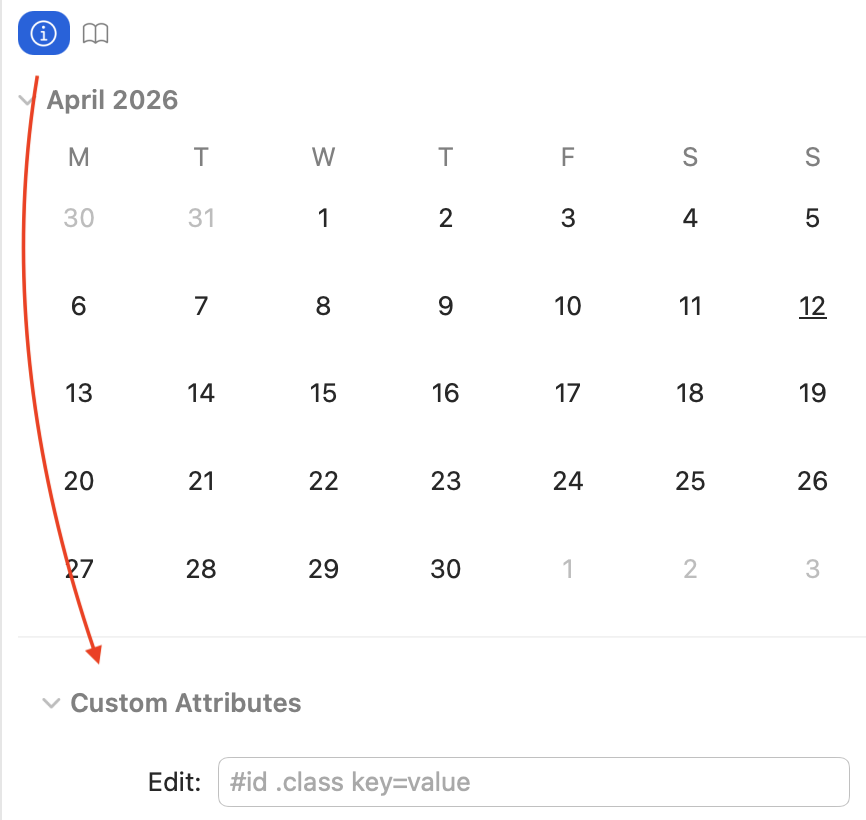

The two core inspector extensions – Calendar, and Word Explorer, have their own tabs and icons.
Can user extensions add a tab and icon in that way ?

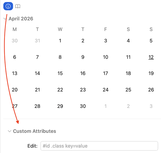

What I am doing at the moment seems to be adding a further inspector panel at the foot of the Calendar tab, which is workable but:
  1. Widens the calendar – a little slower to read and use
  2. complicates the calendar’s tooltip – appending an additional name
FWIW the rough draft is looking like this:

No, extension API only adds inspector items (doesn’t order them or place them in tabs) and by default they stack vertically in initial tab (and by default, when there is single tab, there shouldn’t be any icon visible). Users can re-order and reposition them in tabs using Bike > Interface Explorer.
Except now that I look at it the code I see that the old “Word Explorer” extension is providing a “tab” parameter. I removed that from the API, but code is still reading and using as hint for tab. That’s why Word Explorer is showing up in own tab by default. I’ll remove that path.
Also, the “Word Explorer” extension should be deleted and replaced with “Lookup” extension. Same extension feature, I just renamed when reorganizing extension kit code a few releases back. You install the Lookup extension via: Bike > Extensions Explorer > Browse and then install.
Hope that helps, tell me to clarify anywhere that still doesn’t make sense.
