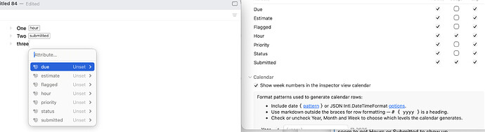

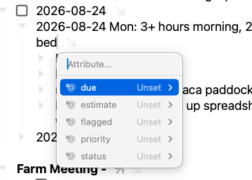

Great changes thank you. I notice that the attributes in the settings are: Due, Estimate, Flagged, Hours, Priority, Status and Submitted. Only Due, Status, Priority, Estimate and Flagged show up in the palette. I can’t seem to get Hours or Submitted to show up.
I think my terminology might be off/confusing. When I say palette I mean:
Not the macOS context menu. Your custom attributes should show up in the above UI as long as they are selected in the settings table (and being set should be on by default for custom attributes)
Does that explain it?
It does, but I still can’t seem to get them to show up in that either…

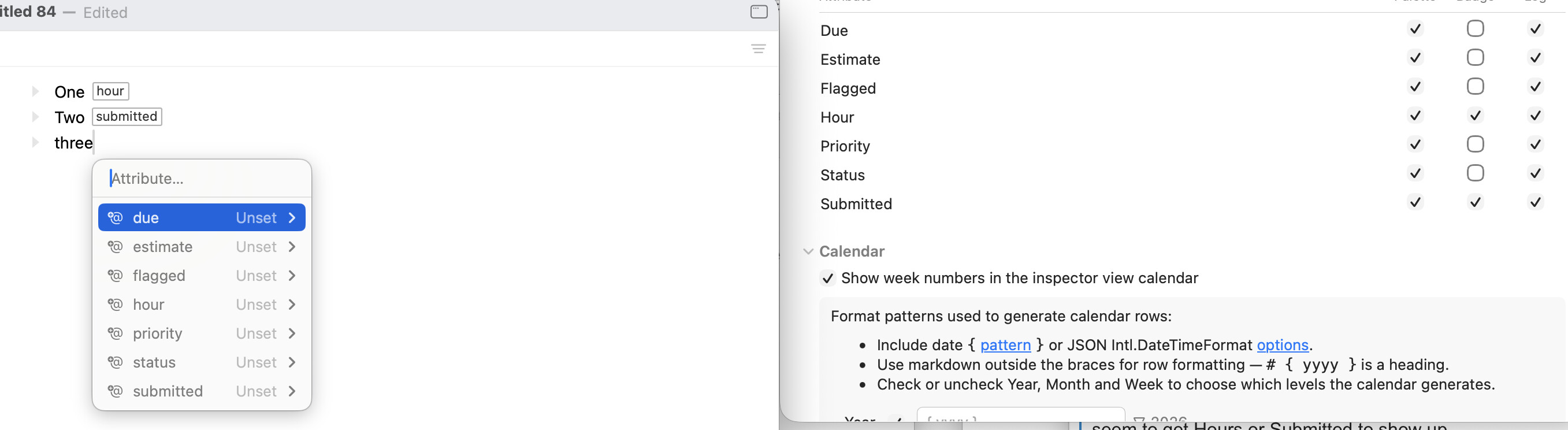

Tried with a fresh document rather than a long-standing Bike one and it’s still the same.
Hum, that’s odd. Not sure why I’m seeing and you are not. Could you send me the example document you are testing with?
It’s the same with any Bike document for me, new or old. I’ll send one through.
Thanks, yeah I see nothing odd about that document, but it lead me to one way to recreate the problem. There are actually two sources of information that I’m pulling on when building that attributes editor view:
  1. I read all existing attributes in the current document + attributes declared by extensions
  2. I then compare those attributes the attributes table settings in extension settings
  3. And that’s how I build the final list
The important point is your document will only list a custom attribute, such as hour, when it is already used in your document at least once. Does that explain what you are seeing?
For example the same document that you sent me would not list “hour” because it does not include that attribute. On the other hand “hour” is listed in your extension settings because some other document listed it once.
Hopefully that explains what you are seeing. Next problem is to figure a better UI if that does explain it.
Thanks for looking into it. I see what’s happening and now that I understand the logic I can happily work with that.
I’m going to make some UI fixes too, but glad you’ve got it working well enough now.
