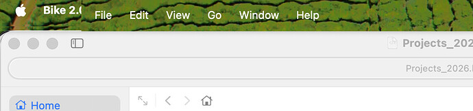

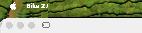

I hide my menu bar, and this is what i now see with 270 (wasn’t like this with 269)
i think this is a bug

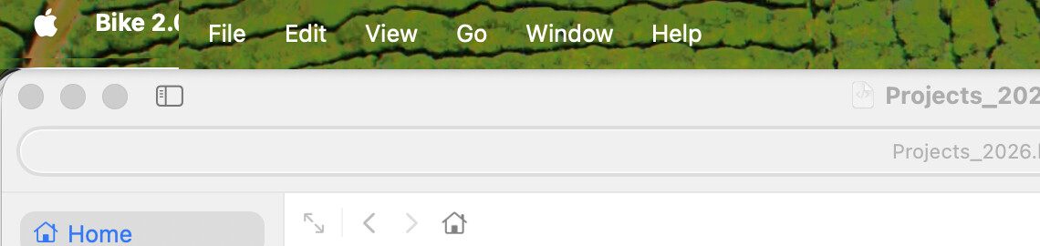

I just noticed that View > Hide / Show Interface appears somewhat broken… I think it maybe a new problem caused by macOS 26.4. I just updated and I think it was working on previous OS. Anyway, I’ll look into it.
Well that’s weird looking. You’ve probably told me many times, but what OS version are you on? I’m not able to reproduce this on macOS 26.4.

macOS 26.4 (25E246)
huh, it’s gone. chalk it up to a ghost

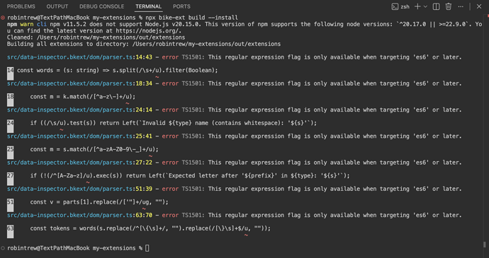

At build of a module in which I have used the regular expression u flag: I am getting the message:
TS1501: This regular expression flag is only available
when targeting 'es6' or later.
Is it safe for me to add a post es6 value for compilerOptions.target in a tsconfig ?

In the dom directory of a .bkext, I have a parser.ts file with the contents below (still in progress) which is imported in an inspector.tsx file with a line like:
import { parsePandocString } from './parser';
Expand disclosure triangle to view TS source
const VALID_ROW_TYPES = [
    'body', 'heading', 'quote', 'code', 'note',
    'unordered', 'ordered', 'task', 'hr'
// Generic Either types
type Either<L, R> = { type: "Either"; Left: L } | { type: "Either"; Right: R };
const Left = <L>(x: L): Either<L, never> => ({ type: "Either", Left: x });
const Right = <R>(x: R): Either<never, R> => ({ type: "Either", Right: x });
export const bindLR = <L, R>(lr: Either<L, R>) => <R2>(mf: (r: R) => Either<L, R2>): Either<L, R2> =>
    "Left" in lr ? Left(lr.Left) : mf(lr.Right);
// String helpers
const words = (s: string) => s.split(/\s+/u).filter(Boolean);
// Validators
const validCustomDataKeyLR = (k: string): Either<string, string> => {
    const m = k.match(/[^a-z\-]+/u);
    return m ? Left(`Unexpected '${m.join("")}' in '${k}' (use lower a-z and hyphens)`) : Right(k);
const validNameLR = (isClass: boolean) => (s: string): Either<string, string> => {
    const [prefix, type] = isClass ? [".", "class"] : ["#", "identifier"];
    if ((/\s/u).test(s)) return Left(`Invalid ${type} name (contains whitespace): '${s}'`);
    const m = s.match(/[^a-zA-Z0-9\-_]+/u);
    if (m) return Left(`Unexpected '${m.join("")}' in ${type} name '${s}'`);
    if (!(/^[A-Za-z]/u).exec(s)) return Left(`Expected letter after '${prefix}' in ${type}: '${s}'`);
    return Right(s);
const validPrefixCharLR = (token: string): Either<string, string> => {
    const prefix = token[0];
    return ".#".includes(prefix) ? Right(prefix) : Left(`Expected '.' or '#'. Saw '${prefix}'`);
// Token Parsers
const readNameLR = (token: string): Either<string, [string, string]> =>
    1 < token.length
        ? bindLR(validPrefixCharLR(token))((prefix: string) =>
            bindLR(validNameLR("." === prefix)(token.slice(1)))((name: any) => Right([prefix, name]))
        : Left(`No name seen after prefix '${token}'`);
const readKVLR = (token: string): Either<string, [string, string]> => {
    const parts = token.split("=");
    if (parts.length !== 2) {
        return Left(`Expected single "=", saw ${parts.length - 1} in ${token}`);
    const k = parts[0];
    const v = parts[1].replace(/[\'\"]+/ug, "");
    // Intercept 'type' and validate against Bike's RowType API
    if (k === "type" && !VALID_ROW_TYPES.includes(v)) {
        return Left(`Invalid type '${v}'. Allowed: ${VALID_ROW_TYPES.join(", ")}`);
    return bindLR(validCustomDataKeyLR(k))(validK => Right([validK, v]));
// Main Parser Export
export const parsePandocString = (s: string): Either<string, Record<string, any>> => {
    const tokens = words(s.replace(/^[\{\s]+/, "").replace(/[\}\s]+$/u, ""));
    const kvs: [string, string][] = [];
    for (const token of tokens) {
        const result = token.includes("=") ? readKVLR(token) : readNameLR(token);
        if ("Left" in result) return result; // Fail fast on first error
        kvs.push(result.Right);
    const dict = kvs.reduce((acc: any, [k, v]) => ({
        ...acc,
        [k]: "." === k ? (acc[k] || []).concat(v) : v
    return Right(dict);

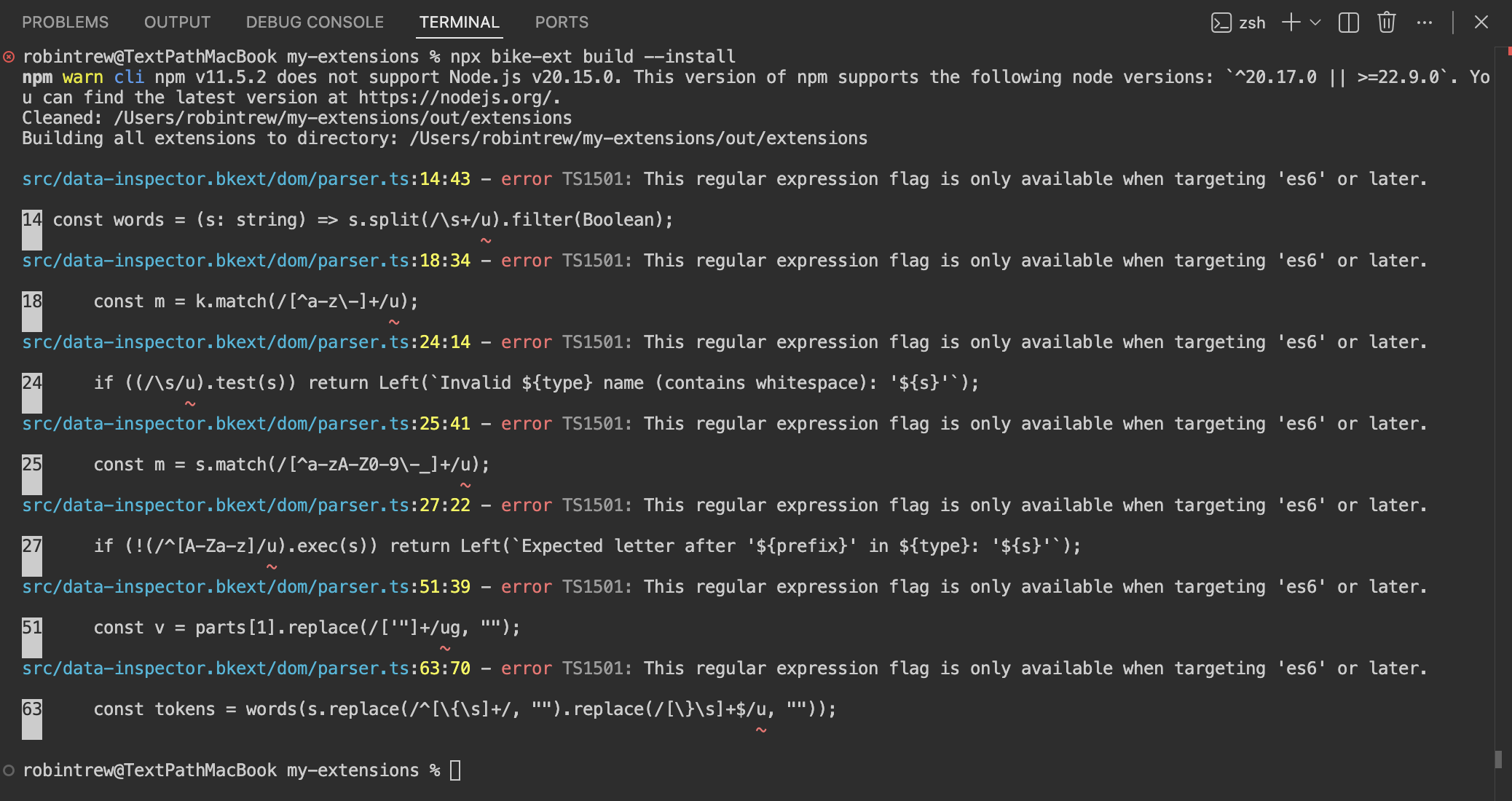

at build time, unless I remove all the /../u flags, I see:
Expand disclosure triangle to view messages
src/data-inspector.bkext/dom/parser.ts:14:43 - error TS1501: This regular expression flag is only available when targeting 'es6' or later.
14 const words = (s: string) => s.split(/\s+/u).filter(Boolean);
src/data-inspector.bkext/dom/parser.ts:18:34 - error TS1501: This regular expression flag is only available when targeting 'es6' or later.
18     const m = k.match(/[^a-z\-]+/u);
src/data-inspector.bkext/dom/parser.ts:24:14 - error TS1501: This regular expression flag is only available when targeting 'es6' or later.
24     if ((/\s/u).test(s)) return Left(`Invalid ${type} name (contains whitespace): '${s}'`);
src/data-inspector.bkext/dom/parser.ts:25:41 - error TS1501: This regular expression flag is only available when targeting 'es6' or later.
25     const m = s.match(/[^a-zA-Z0-9\-_]+/u);
src/data-inspector.bkext/dom/parser.ts:27:22 - error TS1501: This regular expression flag is only available when targeting 'es6' or later.
27     if (!(/^[A-Za-z]/u).exec(s)) return Left(`Expected letter after '${prefix}' in ${type}: '${s}'`);
src/data-inspector.bkext/dom/parser.ts:51:41 - error TS1501: This regular expression flag is only available when targeting 'es6' or later.
51     const v = parts[1].replace(/[\'\"]+/ug, "");
src/data-inspector.bkext/dom/parser.ts:63:70 - error TS1501: This regular expression flag is only available when targeting 'es6' or later.
63     const tokens = words(s.replace(/^[\{\s]+/, "").replace(/[\}\s]+$/u, ""));                                        ~
Perhaps parser.ts should import a missing context ?
Interesting… and odd!
When I include and build that parser code I see no errors at build time. On the other hand I do get an error at runtime (shows in Bike’s Logs Explorer). That error is that /[\'\"]+/ug is not a valid Javascript regular expression and instead needs to be /['"]+/ug. Once I do that I get no errors at build or runtime.
How are you building. Can you show me terminal command and exact output you are seeing?
Part of that oddity (['"]) may arise from the fact that I had taken out all the /u and put them back a bit roughly with search and replace, but more broadly, what I am doing and seeing is:
