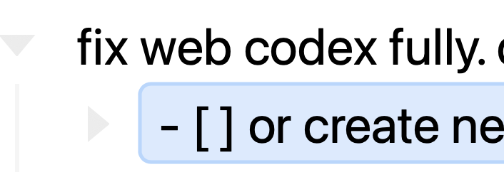

I use Bike as outliner of tasks I work on. I do this to create new such task to work on:
And I need a palette that lets me fuzzy find a top level task to switch too. Super important for my workflow. Hope you can add this.
Thank you lots.

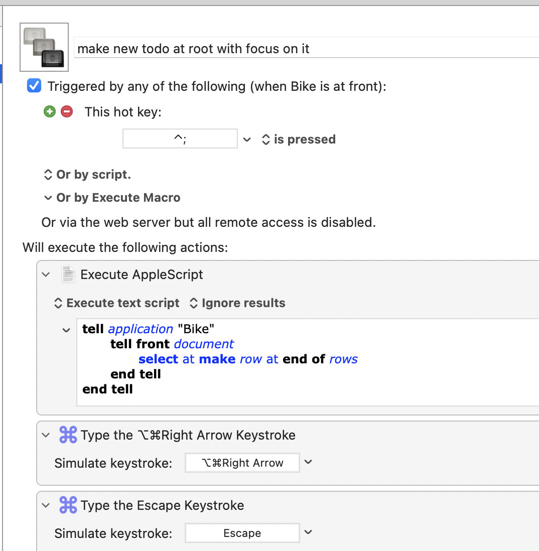

Also this
tell application "Bike"
	tell front document
		select at make row at end of rows
	end tell
end tell
No longer does what it did in Bike 1.
Is there a new something I can use. I need smth that will let me create a new item at the root (end of document) with focus on it.
It seems to work here – I wonder whether you still have Bike 1 installed, in addition to Bike 2 ?
(The trick is to ensure that the right version gets targeted by the AppleScript)
It is working for me, but it does have slightly different behavior related to the end UI state.
(I will look more into that)
@nikivi With that said, you might have better luck looking into the new extension’s API. That API will give you much more control and integrate more deeply with Bike. It is a learning curve to setup the environment, but then I think dev is quite a bit easier then AppleScript based dev.
I think in the past you’ve posted about creating very specific keystroke workflows. With the extension API you can set code to run with single key bindings, or sequences of keys. I think you might like it.
