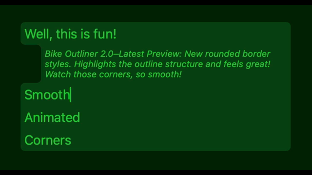

Here’s an experimental style demo that uses new mergable for rows:
Pleasingly quietened and organic feel to the indenting edge of multiple row selections :slight_smile:
( one left edge rather than many – less distracting to the eye )
:+1:
( wouldn’t have occurred to me )
Yeah, just a demo at this point, but I’ve always wondered what it would feel like to highlight the outline structure this way in a full theme. Block selection now gives a somewhat similar effect in the default theme. Highlights the outline structure much more then before I think.
Core style rule to enable this effect is:
row(`.*`, (editor, row) => {
  row.padding = new Insets(0, 0, 0, 28)
  row.text.padding = new Insets(5, 5, 5, 5)
  row.decoration('background', (background, layout) => {
    background.anchor.x = 0
    background.anchor.y = 0
    background.x = layout.leadingContent
    background.y = layout.top
    background.width = layout.width.offset(layout.leadingContent.scale(-1))
    background.height = layout.text.bottom.minus(layout.top).offset(row.text.margin.bottom)
    background.color = Color.systemGreen().withFraction(0.7, Color.black())
    background.corners.radius = 6
    background.mergable = true
    background.zPosition = -2
