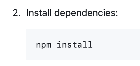

Follow the steps in the kit’s README.md file.
Am I right in thinking that in the Getting Started section of that file:
Is a once-off which assumes that we have changed the current directory to that in which the kit has been installed ?
Yes. I need to make that clearer, thanks.
So if the bike extension kit is at ~/bike-extension-kit,
then following the incantations:
cd ~/bike-extension-kit
npm install

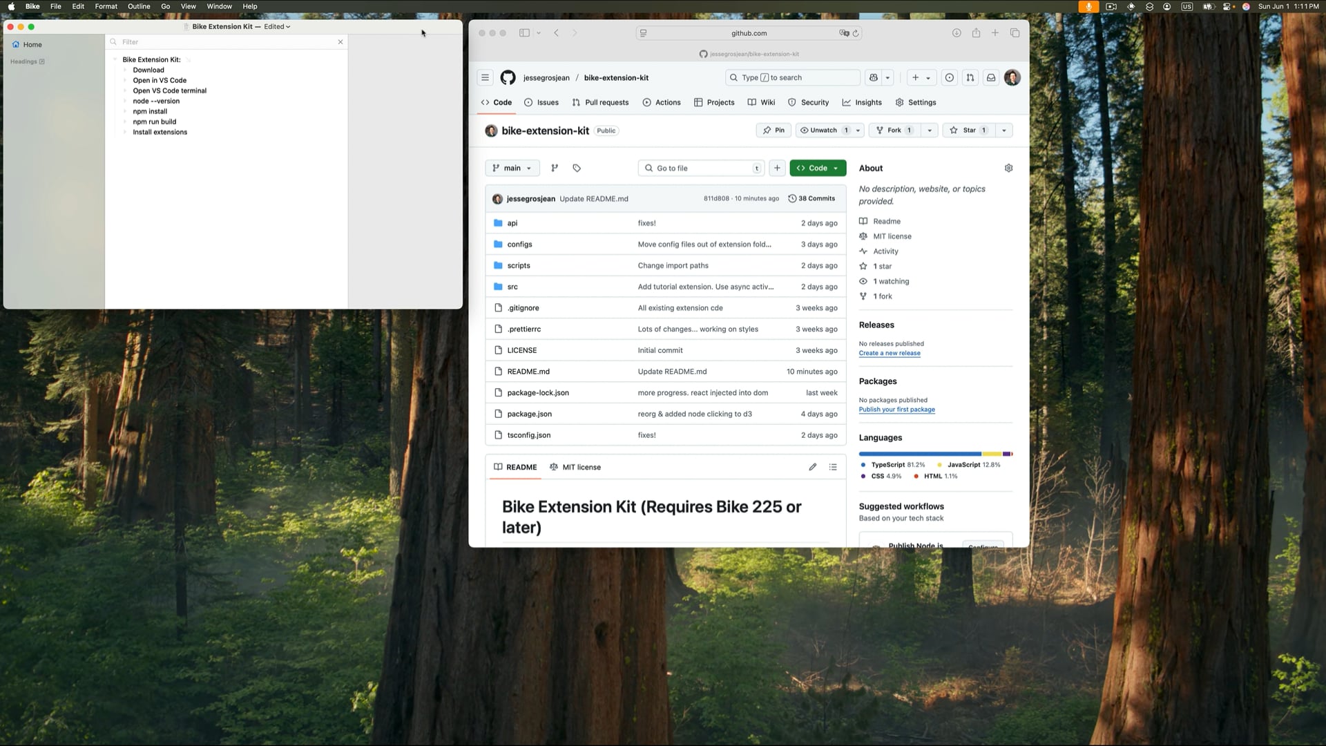

I’ve just posted a quick video tutorial showing how the kit should work:
