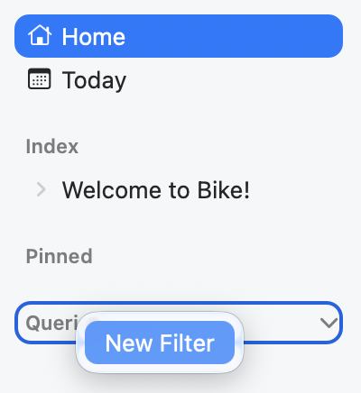

I don’t see the built-in queries on the side anymore, and it’s not clear how to add them. I’m pretty sure it’s in the forum somewhere, but can someone help point me in the right direction?

In the sidebar right-click on the “Queries” heading and you’ll get option to create a “New Filter”.
