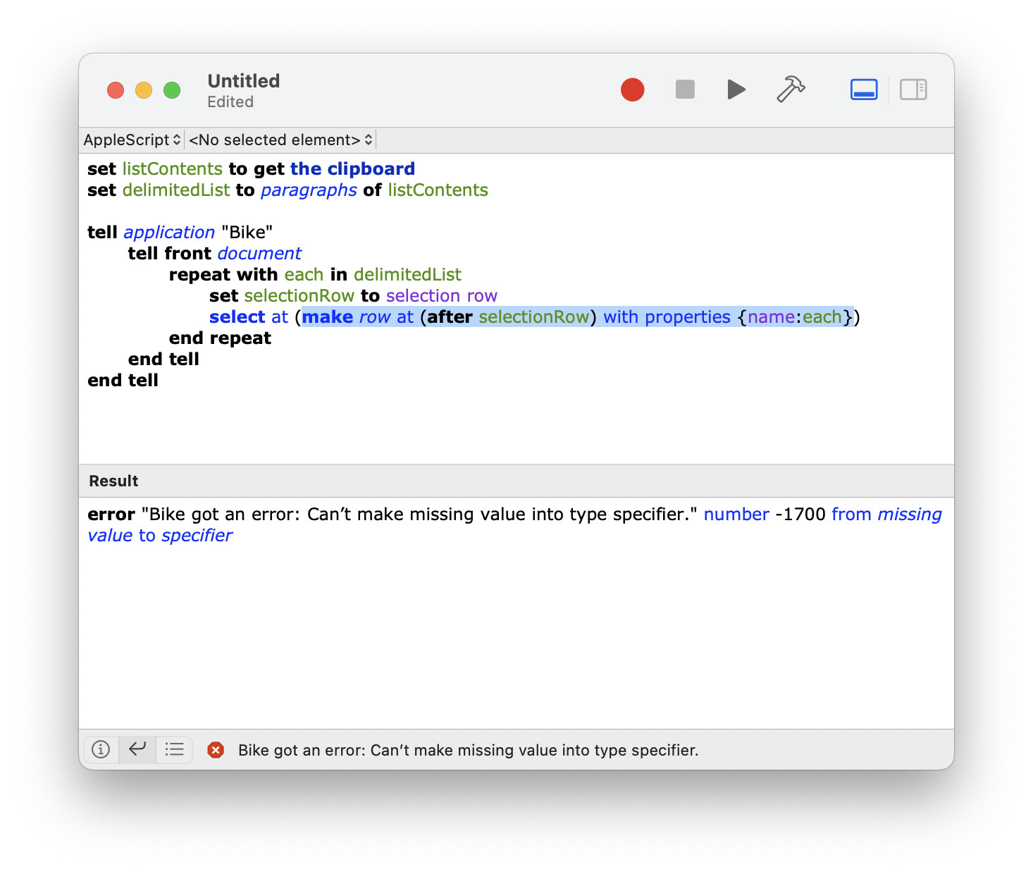

I think this pretty much does what you want. Give it a try and let me know if this is behavior you are looking for.
set listContents to get the clipboard
set delimitedList to paragraphs of listContents
tell application "Bike"
	tell front document
		repeat with each in delimitedList
			set selectionRow to selection row
			select at (make row at (after selectionRow) with properties {name:each})
		end repeat
	end tell
end tell
Thanks so much for getting back to me! Unfortunately I hit the following error running the AppleScript you sent:
error "Bike got an error: Can’t make missing value into type specifier." number -1700 from missing value to specifier
I am running Bike 1.12. I think I get the idea though and don’t want to take up more of your time—I’ll play around with the AppleScript. Thank you!
That only happens here if I don’t have a front document open in Bike.
Otherwise, each line of the current (textual) clipboard contents is pasted with its leading space into the frontmost of the documents that are open in Bike.
